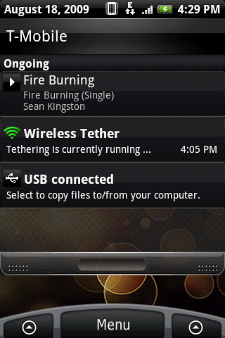

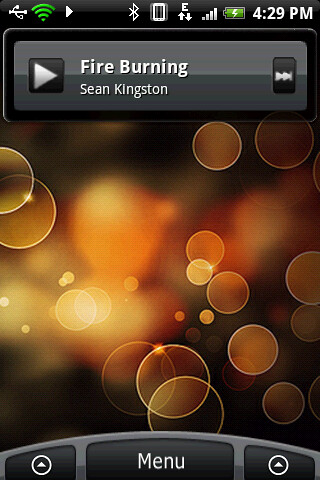

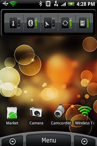

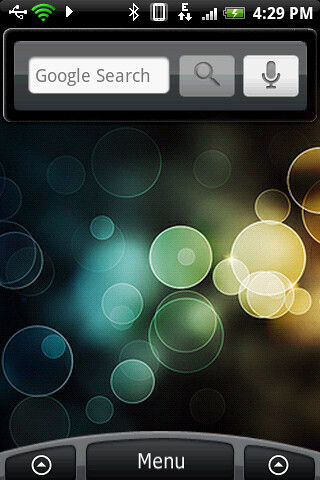

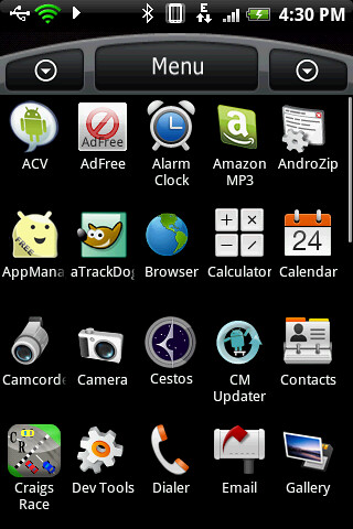

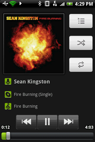

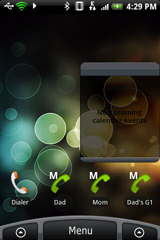

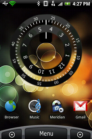

    Enligt ett annat forum så kan du installera följande tema genom att följa nedan instruktioner. Jag har själv inte testat temat för jag använder inte CM just nu. Jag testar TheNano's bygge för tillfället :)
    [​IMG] [​IMG]
    [​IMG] [​IMG]
    [​IMG] [​IMG]
    [​IMG] [​IMG]
    ***COPY AND PASTE STARTS!!!***
    HOW-TO FOR n00bS!!!
    ROOT IS REQUIRED FOR MY THEME!!!
    This is very important!!!:
    -Make sure that you do NOT have an Analog Clock on any of your home screens!
    How to install my theme:
    1. Download
    2. Copy to Root of SDcard(as in NOT IN A FOLDER!!!)
    3. Rename to "update.zip" or if you dont see a ".zip" in the end of the name before you rename it, just rename it "update"
    4. Shut down phone
    5. Go into Recovery(Press Home + Power)
    6. -If you don't see any options, press Alt-L then Alt-S
    -If you do see options, just press Alt-S
    7. Now just restart your phone by pressing Home + Back
    8. Wait for 5-10 minutes... 15 minutes at most... if it doesnt show the homescreen in 15 minutes... you'll need to wipe and install a fresh copy of CyanogenMod...
    9. There you have it!
    -Make sure that you do NOT have a Music Widget on any of your home screens!
    -Make sure that you have my theme installed first!
    NOTE: This will replace the original Music app.
    How to install HTC Music:
    1. Download
    4. Shut down phone
    ***COPY AND PASTE ENDS!!!***
    Download Theme: (4Shared)
    NOTE: Install my theme before you flash HTC Music, Hero Ringtones, or Advanced Launcher...
    Download HTC Music: (4Shared)
    Download Hero Ringtones and Notifications: (4Shared)
    Download Hero Wallpapers: (http://www.4shared.com/file/124941404/1fa36b95/Hero_Wallpapers.html)
    Download Themed Advanced Launcher.apk: (4Shared)
    Teds Hero Theme XDA Post
