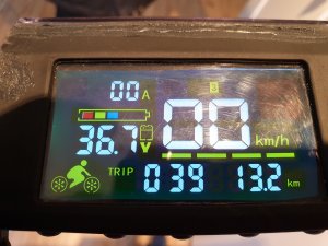

Though a bit strange regarding the light.
Blinking back light should only mean you have activited the light on the front as well.
Then when breaking with lights on it will be a steady red back light insteed.
So might be something else then the Hall IC.

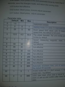

Though the indication that brake is on at the display when you turn on the scooter indicates that something is wrong with the Hall IC if I remember the Ryssians correctly.
