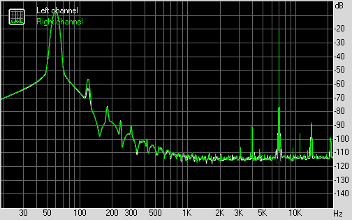

Frequency response
Spectrum graph
From 20 Hz to 20 kHz, dB
-2.54, +1.43
From 40 Hz to 15 kHz, dB
-0.85, +1.43

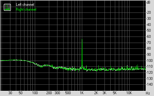

Noise level
Spectrum graph
Left
Right
RMS power, dB
-79.7
-79.5
RMS power (A-weighted), dB
-83.9
-83.8
Peak level, dB FS
-59.6
-59.6
DC offset, %
-0.0
-0.0

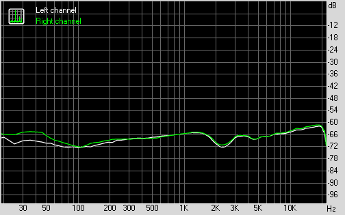

Stereo crosstalk
Spectrum graph
Left
Right
Crosstalk at 100 Hz, dB
-71
-71
Crosstalk at 1000 Hz, dB
-64
-64
Crosstalk at 10000 Hz, dB
-64
-63

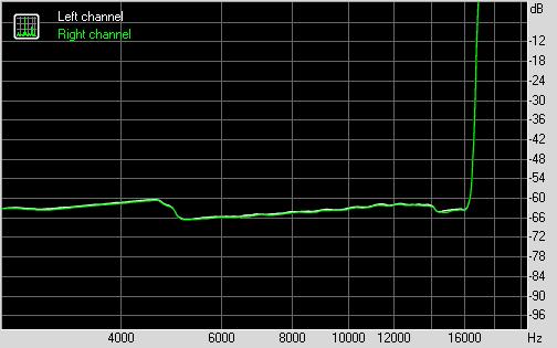

IMD (swept tones)
Spectrum graph
Left
Right
IMD + Noise at 5000 Hz,
0.0584
0.0580
IMD + Noise at 10000 Hz,
0.0708
0.0678
IMD + Noise at 15000 Hz,
0.0660
0.0621
