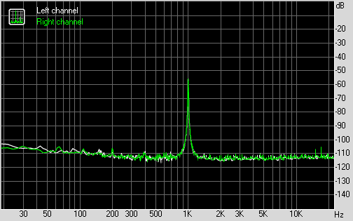

Noise level
Spectrum graph
Left
Right
RMS power, dB
-81.8
-81.7
RMS power (A-weighted), dB
-83.0
-82.8
Peak level, dB FS
-60.2
-60.2
DC offset, %
-0.0
-0.0

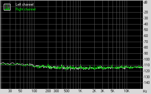

Dynamic range
Spectrum graph
Left
Right
Dynamic range, dB
+81.8
+81.6
Dynamic range (A-weighted), dB
+82.9
+82.7
DC offset, %
-0.01
-0.01

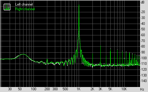

THD + Noise (at -3 dB FS)
Spectrum graph
Left
Right
THD, %
+0.0386
+0.0353
THD + Noise, %
+0.0456
+0.0426
THD + Noise (A-weighted), %
+0.0517
+0.0483

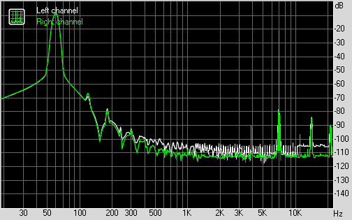

Intermodulation distortion
Spectrum graph
Left
Right
IMD + Noise, %
+0.0758
+0.0961
IMD + Noise (A-weighted), %
+0.0502
+0.0477

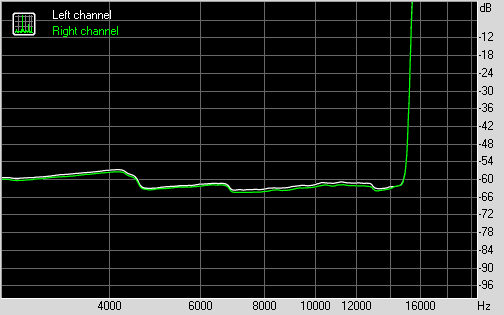

IMD (swept tones)
Spectrum graph
Left
Right
IMD + Noise at 5000 Hz,
0.0730
0.0698
IMD + Noise at 10000 Hz,
0.0820
0.0746
IMD + Noise at 15000 Hz,
0.2203
0.2165
