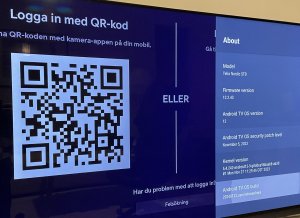

    hi all,
    Sorry to write in English. Live here for years but still not able to speak Swedish.
    I got a TV Box DV8919X from Telia, and want to hack it.
    Reading some post before, it is possible to enable ADB, and do many things.
    But on my device, the box asks for a password to enable ADB.
    Extra info:
    Model: Telia Nordic STB
    Firmware version: 12.2.43
    Android TV OS version: 12
    Android TV OS security patch level: Nov 5,2023
    Kernel version: 5.4.242 (Nov 27, 2023)
    Android TV OS build: 20240123:user/release-key

  2. Heleg
    5 feb 2016
    3 099
    2 176
    Maybe factory reset is the way to go.

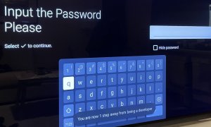

    Just tried.
    Factory reset
    Scan Telia QR code for first time login
    Try to enable ADB, still need a passion in the final step.
    Maybe they add the password in the system firmware

    Hi, I am trying to enable dev mode.
    I think most of Android devices can enable dev mode by 7 (or more) clicks on OS version.
    But this device and this version seems have password protection.
    Without this step, I think it is not possible to use ADB commands from PC.

    I have done this several times before, every time without being promoted for a password. Perhaps they have added the password prompt in the last system update...? :mad:

  16. Muchen
    Muchen Infant Droid Medlem
    16 mar 2024
    7
    Unfortunately no reply from SDMC. As I cannot enable ADB, cannot root, there are not much to do.
    But since there is a Google Play (App Store), I did these:
    - Use Flauncher instead of Telia's launcher
    - Use Button Mapper to map one key to start Flauncher
    So even I didn't log in Telia's account, I can use Flauncher to use it as a normal Android TV
    Sorry I don't have inspiring update
