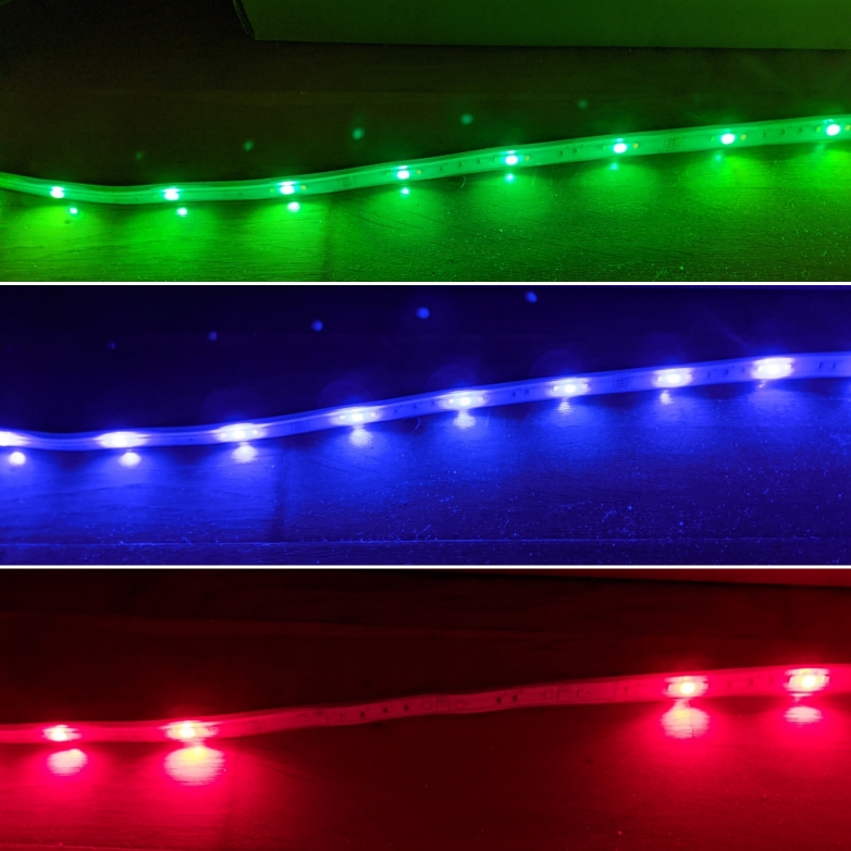

    Kopplade in min impulsköp-strip. Tre LEDar i rad lyser inte rött. Bra start.

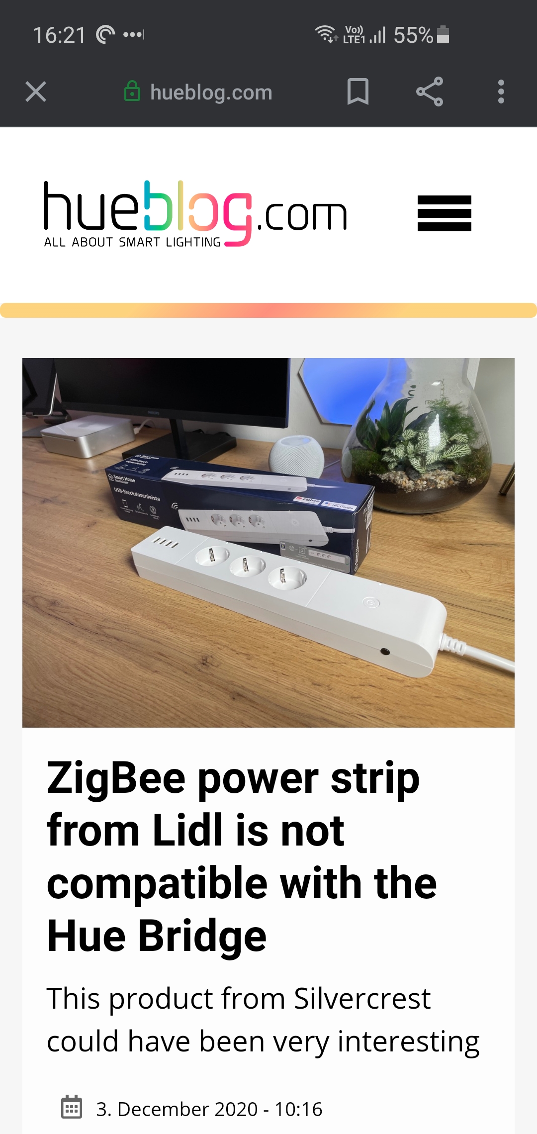

    Sett på annat forum att Färglamporna samt uttagen fungerade bra med Hue hub
    /Rob

    Jag köpte grendosan men får den inte att funka med min Hue hub. Orkar inte mecka så jag tänker lämna tillbaka den.
    3 st GU 10 funkade dock finfint att lägga till i Hue bryggan. Alexa var på hugget o hittade dem med helt utan handpåläggning.
    Edit: Hittade denna vid snabb googling

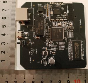

    Hittade följande info, sökte på om det gick lägga in tasmota firmware men det går inte
    MattWestb from the Tasmota community pointed out that definitely is just a rebranded version of the standard Tuya TYGWZ-01 Zigbee Smart Life Gateway (TYGWZ01) hardware in a other enclosure so that means that the FCC has more pictures of the board here including those without that metal casing:
    https://fccid.io/2ANDL-TYGWZ01 13
    https://fccid.io/2ANDL-TYZS4 4
    https://zigbeealliance.org/zigbee_products/tuya-smart-gateway/ 12
    As can see it has unfortunately not an ESP8266 or ESP32 WiFi SoC but instead that RTL8196E is the WiFi/MCU SoC from Realtek running Linux as its operating system, and underneath that metal housing is only the Zigbee chip from Silicon Labs which is an EFR32 Series 1 (previous generation) thus similar to that what is on the Sonoff ZBBridge by ITead though it features an EFR32 Series 2 (newest generation) of Zigbee SoC.
    Regardless it using RTL8196E WiFi/MCU chipset instead of ESP8266/ESP32 means no support for Tasmota.
