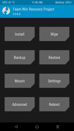

    uppdaterat första posten med ny version av TWRP.
    gör följande (står även i OP)
    FULL STEPS FOR OBTAINING ROOT
    1. In your ROM, go to Settings -> About device. Tap 7 times on Build number to enable Developer options.
    2. Now go to Settings -> Developer options. (above About device)
      You need to enable OEM unlock, otherwise you might end up with boot problems or be unable to flash later on.
    3. Extract Odin_3.10.7.zip to your computer.
    4. Install Samsung Mobile Phone Drivers for Odin to find your device.
    5. Download a tar.md5 image of TWRP for herolte.
    6. Reboot your device into Download mode. To do this, select reboot from the power menu and hold the [Volume Down] + [Home] buttons while your device reboots.
      Once you reach the Download mode warning screen, press [Volume Up] to continue.
    7. Open Odin and place that tar.md5 in the [AP] slot without touching any other options, then press [Start].
    8. Hold [Volume Up] + [Home] buttons near the end of the flash, and keep holding them until you are in recovery.
    9. Go to [Wipe] -> [Format Data] (not advanced wipe) -> type "yes".
      WARNING: This will wipe your internal storage, disable encryption, and factory reset your phone!
    10. Go to [Reboot] -> [Recovery].
    11. Download dm-verity and force encryption disabler.
      Without exiting TWRP, transfer no-verity-opt-encrypt.zip to your device over MTP* and flash it using [Install] in TWRP.
    12. Download the latest SuperSU by Chainfire.
      Without exiting TWRP, transfer the SuperSU zip to your device over MTP* and flash it using [Install] in TWRP.
    13. Go to [Reboot] -> [System].
    14. Wait 5-15 minutes for your device to finish setting itself up.
